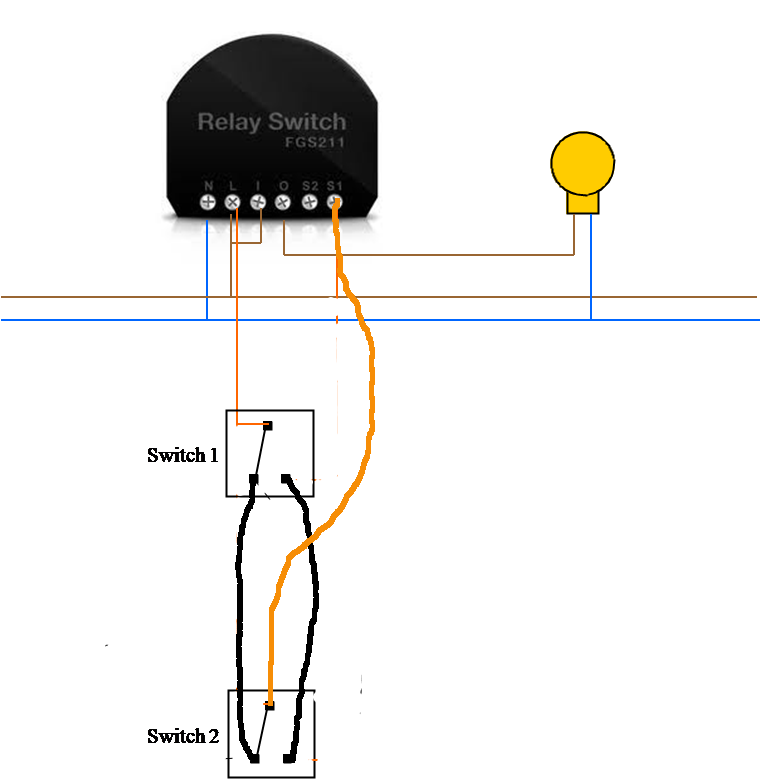

the wiring should be according the figure below.

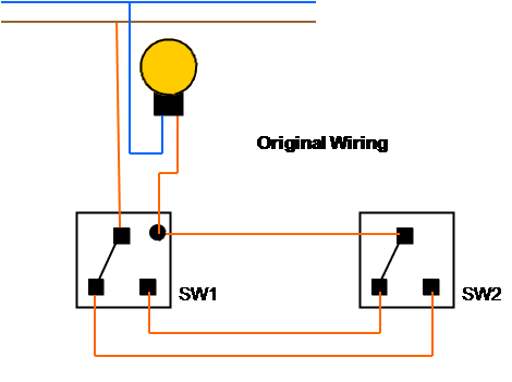

If you compare this with the hotel/wissel schakeling picture; the fibaro is in between switch 2 (fibaro In, S1) and the lamp (Fibaro Out, O).

Sorry. I assumed mono stable (momentary) switches in my first diagram.
For bi stable switches the wiring should be as the above post by geert-jan. The Fibaro module also needs to be configured for bi stable switches (parameter 14)
S2 is used when you want to control another device by association.
In a normal UK "hotel switch" configuration there will be no neutral (blue) wire in either switch location, so the Fibaro FGS module would either need to be installed at the connection point for the circuit or a neutral wire would need to be installed at switch 1.
