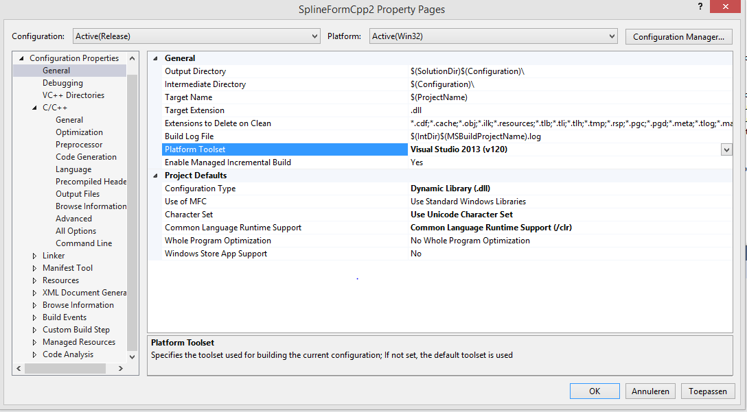

it runs on windows 8.1 64 bit . according to the platform toollset the 2013 version of the c++ redistributable should do it, did You restart the computer ?
i will now try to compile it with the dependencies as in this response is suggested
http://stackoverflow.com/questions/1970 ... o-msvcr100

i did put the buienradargps on a remote computer with vista 32 bits, i got the same error the slineformcpp.dll or it dependicies couldnt load. but after downloading c++ redistributable for visual studio 13 file version version 12.0.2501.1 it worked.
http://www.microsoft.com/en-us/download ... x?id=40784

Labium it works , thnx! . Important is that you install the 86 version even on a 64 bit machine.
