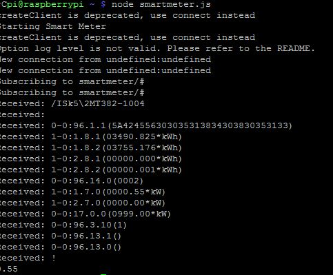

Hi again,
I tried and i found i think the right one only it gives again an error what i do not understand. i even did a full reinstall from scratch.
createClient is deprecated, use connect instead
Starting Smart Meter
Received: /ISk5\2MT382-1004
Received:
Received: 0-0:96.1.1(5A424556303035313834303830353133)
Received: 1-0:1.8.1(02807.594*kWh)
Received: 1-0:1.8.2(03050.524*kWh)
Received: 1-0:2.8.1(00000.000*kWh)
Received: 1-0:2.8.2(00000.001*kWh)
Received: 0-0:96.14.0(0002)
Received: 1-0:1.7.0(0000.39*kW)
Received: 1-0:2.7.0(0000.00*kW)
Received: 0-0:17.0.0(0999.00*kW)
Received: 0-0:96.3.10(1)
Received: 0-0:96.13.1()
Received: 0-0:96.13.0()
Received: !
/home/pi/smartmeter.js:111
            parseInt(telegram[16].substr(11,2)) +  2000,
TypeError: Cannot read property 'substr' of undefined
    at processTelegram (/home/pi/smartmeter.js:111:34)
    at SerialPort.<anonymous> (/home/pi/smartmeter.js:156:13)
    at SerialPort.emit (events.js:107:17)
    at /home/pi/node_modules/serialport/parsers.js:25:17
    at Array.forEach (native)
    at Object.parser (/home/pi/node_modules/serialport/parsers.js:24:13)
    at Object.SerialPort.opts.dataCallback (/home/pi/node_modules/serialport/serialport.js:181:12)
    at SerialPortFactory.SerialPort._emitData (/home/pi/node_modules/serialport/serialport.js:396:20)
    at afterRead (/home/pi/node_modules/serialport/serialport.js:372:20)
    at /home/pi/node_modules/serialport/serialport.js:388:9
what can this be?
thanks in advance

Thanks again. making progress now.
I think the code works. i combined the 2 files. I do not know yet how to use upstart or something like that and want to fuocus first to get this running. i copied the webserver.js into the smartmeter.js and this is the output in shell. seems quite ok i guess.
 pi@raspberrypi ~ $ node smartmeter.js
Option log level is not valid. Please refer to the README.
Received:
Received: 1-0:1.8.1(02810.484*kWh)
Received: 1-0:1.8.2(03059.122*kWh)
Received: 1-0:1.7.0(0000.72*kW)
Received: !
0.72
Received:
Received: 1-0:1.8.2(03059.125*kWh)
Received: !
Received:
Received: 1-0:1.8.2(03059.126*kWh)
Received: 1-0:1.7.0(0000.70*kW)
Received: !
0.7

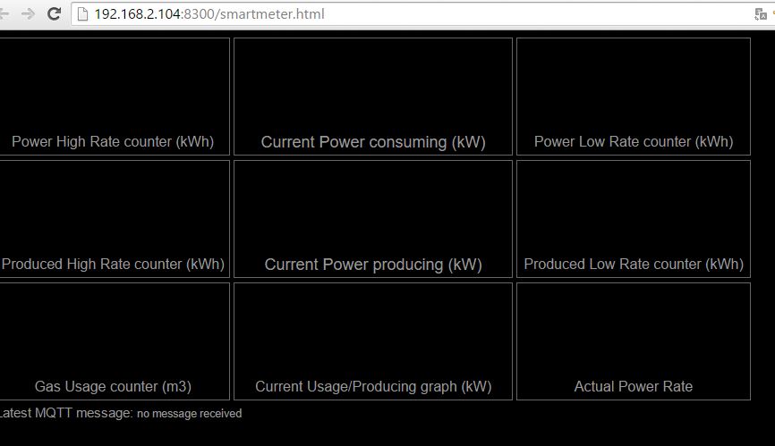

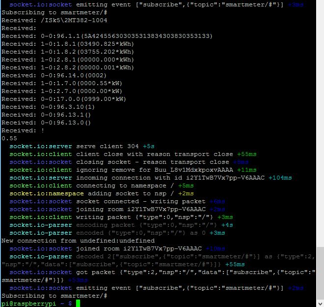

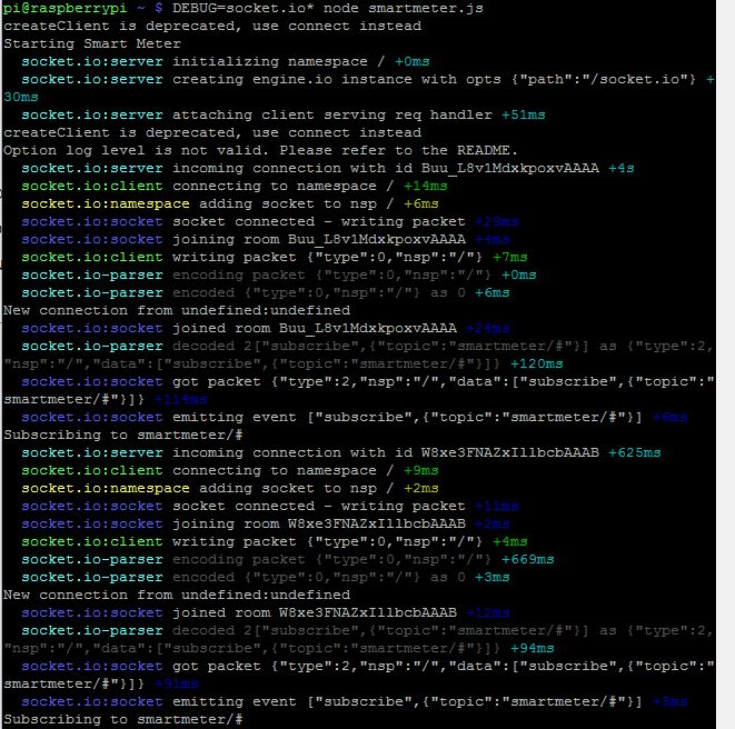

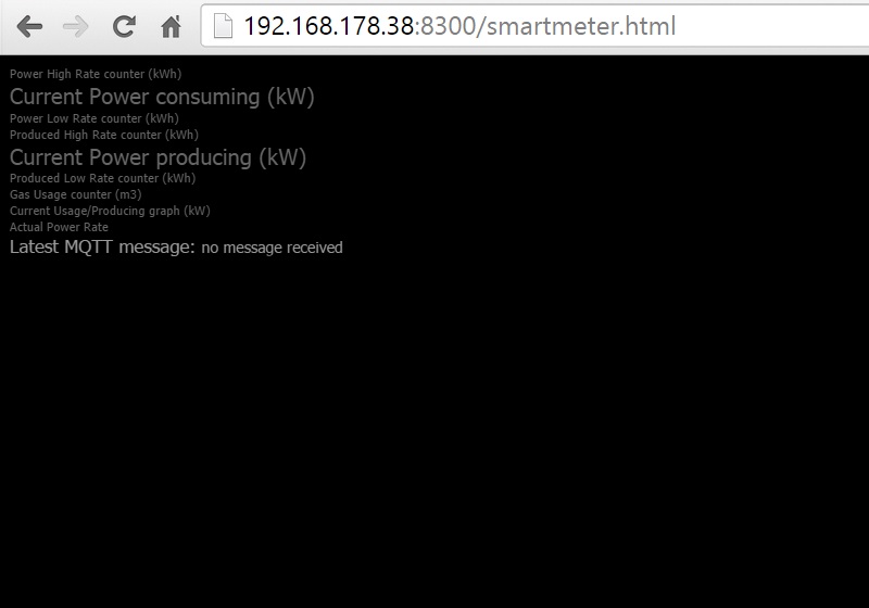

now the folling problem is that my smartmeter.html shows not the data.
i am still missing something but i do not see it.

Re: Bwired Nodejs, MQTT, Websockets Iskra Smartmeter solution
Ok you need to check if your Mosquitto (mqtt) broker is working... are te topics received?
also you use the newest version MQTT nodejs and when i tried that a while back version i could not get it to work with Mosquitto... not sure if its only my problem...but tried a lot!
i use mqtt
It's your problem Pieter ;-) It still works with mosquitto but had some breaking changes, so you need to adapt your code.
@Rene
i know about the Mqtt changes regarding the connect, but even if i do these it was not working with Mosquitto at that time.
perhaps new Mqtt version solved the problem, havent checked yet.
are you working with Mosquitto en latest MQTT version now?
Thanks Pieter
Yes I do.

Hi All,
it is been a wile but i picked up this project again. i still not receiving any data on the website. I will explain what i did.
I followed every bit of the instructions on the website. also on the end i created 1 file for the smartmeter and webserverfile.
serialport = require('serialport'); var mqtt = require('mqtt');

The output on the site is still blank.
the node file gives some errors but after googling i found out that it is not an issue only it would be better to upgrade the files.
The files are working because when i load the website i get the line "New connection from undefined:undefined"
after some digging and trying to get aquainted with nodeJS and the rest i tried to debug the file on the socket.io. maybe it gives some information for you to help out if possible
I really like to work with this and tried a lot by myself but i can't figure it out. (sorry for that)
Can you help me?
