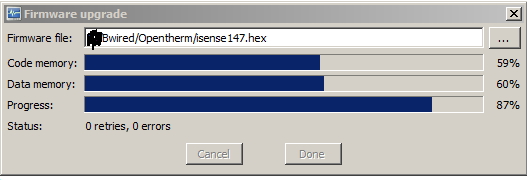

Re: Overriding temperature setpoint with OTG and iSense
Post by bus147 »
@hvxl,
thanks. I've downloaded the firmware. Will apply it shortly, next program change is at 2230h. Current setpoint is stable, I'll raise the setpoint by 0.5 degrees. Before the update some stats from the last three days:
  • error 01 39
  • error 02 4
  • error 03 3373
  • error 04 2
Update applied. Firmware applied, OpenTherm Gateway 3.3.1. Remote room temperature setpoint accepted. The hand symbol appeared on the iSense. And after a few minutes the special bitmask appeared. Unfortunately the WDT reset occured. I'll try again tomorrow.
Testing now :)
One problem solved!
If i make a temp setpoint (TT) this will be set. Then the program on the thermostat takes over according schedule. :)
But im still not able to make a new setpoint after setting the first, this will not be accepted. Override will go to 0 again.
still examining which set-point is taken after this?

Now that setting TT works, I'll test some other scenarios as well:
  • Override temperature via TT and wait till next program change and program setting resumes. Then issue a new TT. Check if that gets accepted and program will resume after program change
  • Override temperature via TT. Manually resume program on the iSense. Then issue a new TT. Check if that gets accepted and program will resume after program change.
I'll look if I can figure out how one can see that the program resumes for example, based on the messages exchanged via the OTG.
One interesting question remains: how should this fix be implemented? Not, and only via a special build made available. Via, a new command eg TP. Or allow the user to configure the bitmask. But first more testing, which is rather time consuming.
Sorry, I updated the above post, I was setting the TT and not TC :oops:
I checked many times now, after setting TT, program pick up again according schedule, so that problem looks solved
Still Setting a TT while ID9 is <> 0 is a problem, this does not work, and thermostat resumes with scheduled program, not the last (current TT)

That's great to read Bwired! Could describe why you want to set another TT? Is it something like: let's raise the temperature 0.5 degC above program. Wait sometime. Mmm, still too cold let's raise the temp another 0.5 degC. If the program/device forgot that a previous TT had been set. Isn't this detectable by looking at MsgId 9 and circumventable by issuing a TT=0 first. What's needed is a state diagram and some notes about timing. Because all these state transition can take minutes. At first I issues commands vary rapidly (a TT per 30 secs or minute) but the iSense didn't like that. With regard to determining the state, is there some command to query the thermostat? For example: are you running from program? Or when does the next program start? Because if you miss some responses you might not reliable determine the state the system is is. Also need to look more carefully at the allowed setpoint values. The iSense control allow for half degree resolution but internally up one hundredth of a degree is used. Can we set that as well or will it mess up the iSense somehow.
Yes i can check ID9 first if its <> 0, but its better when its working :-)
And yes if you raise 0.5 and later again with 2.0 the heating up increases a lot.
Like told before setting override to 0 will immedately activate the scheduld program and can start the hvac
But i think its not a big problem, we can live with it :-)
Good suggestion of you regarding the new firmware!
And thanks to schelte for making it
