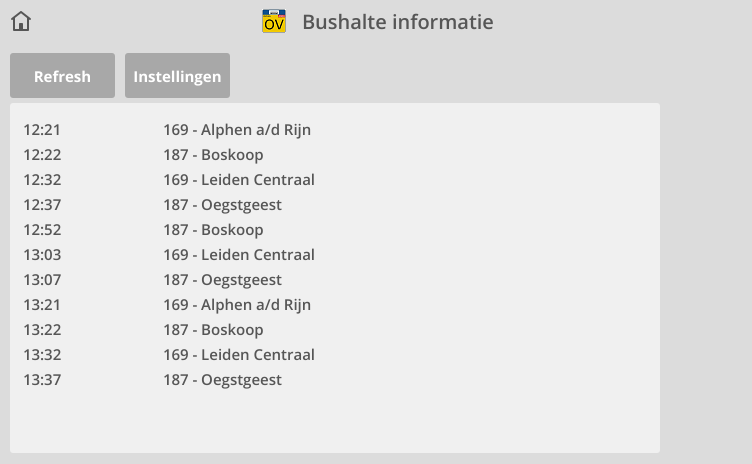

OV information app
Post by atlantica »

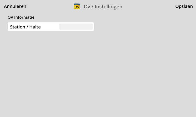

1.) First get the station id from http://api.9292.nl/0.1/locations?lang=nl-NL&q=eindhoven (Change eindhoven to your own search parameter).
2.) Copy the ID and enter this value in the 'Station / Halte' field under settings
Update:
Refresh button is now working
ovinformationapp.zip
(26.88 KiB) Downloaded 571 times

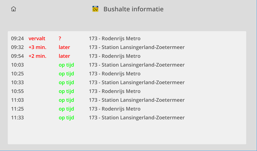

Posts: 1918
Re: OV information app
small teaser, the basics are running again.
Need much more work to simplify the app structure and further enhance it.
The app will not slowdown your toon anymore.
Not sure when it's ready for release....

Posts: 1918
Halte name is already in the WIP version :-).
I also rebuild the config screen to be able to search for a busstop from there. No need to find the busstop id yourself.
Also rebuilt the tile to show the data of the first bus departing.
To do: somehow split/sort the list of departing busses by direction. Useful if the busstop is on both sides of the road
Keep the suggestions coming....
