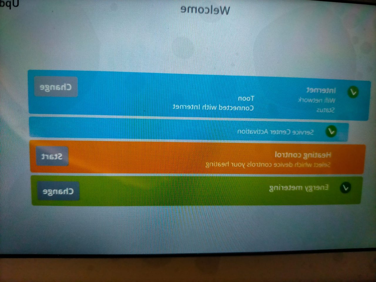

Hi
i have received a new Toon 2
This is what i see.
The display is upside down and mirrored. Touchscreen is right so that there is no synchronism between display and touch.
I have not found a solution. Any more tips ?
Thank you
