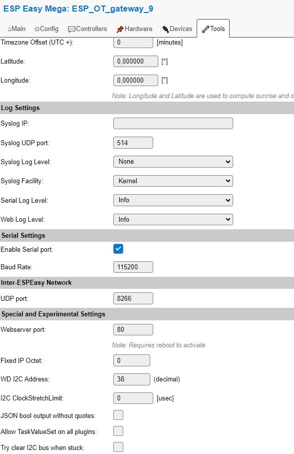

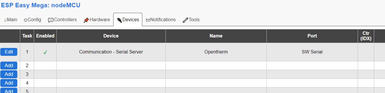

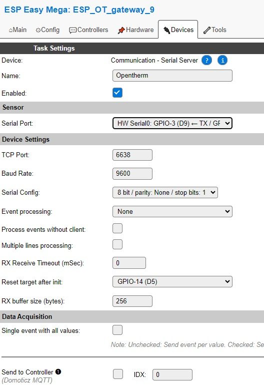

What are the correct settings at the "Devices" tab for the Serial server?
Anything else i can check to get it working and communicating back to Domoticz?

Hi, can you try this? Especially your serial settings seems not OK.
I recently stepped over from v147 (!) to mega-20230507.
For me it.s OK.
