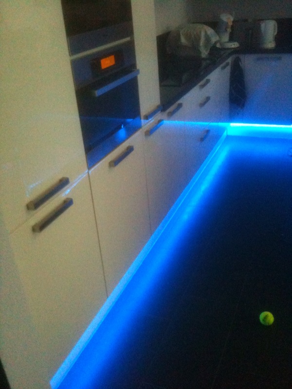

So i ordered a bunch of stuff from marco (moodledlight) and he came over so we could get some work done.. loads of dmx stuff (finally) went into the house.
as a small peak i have a picture of the kitchen floor (made by iphone, so dont blame me) once the rest of all the bits are in place i'll make some proper pictures and stuff.

Looks a bit bright, or is that the iphone cam?
I'm still working hard to get everything in place but we are getting closer and closer. Bathroom almost done, for the hallway downstairs just received the led lights, the kitchen will be placed in mid jan so will show some more picts by then.

its just the iphone indeed, it looks much nicer in real live. You got a boat house on the picture? Nice to place some lights "in" the water :)

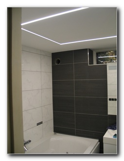

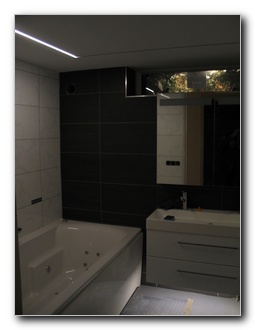

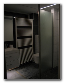

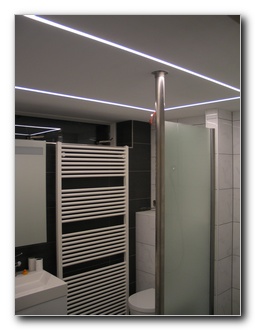

In the mean time I was able to put some more Led light to work, in the bathroom I have integrated a aluminum U shaped strip in the ceiling with a milky white cover, inside the Warm White LED strips have been placed, in total around 7 ( 2 x 1 and 2 x 2,5) meters and 1 meter underneath the cabinet.
The 2 short ones and the cabinet strip are connected to the one dimmer and the 2 long ones are connected to another dimmer.
The effects (no flash was used):
Left side dimmed
Left side dimmed
Left Full light
Left Full light
Right side dimmed
Right side dimmed
Right Side almost full

A close-up of the strip (built flat into ceiling) the strip was first put onto the wood then the plaster plates were put around and after that the ceiling was finished by 'stucadoors' Before they came in we replaced the alu strip with wood same width (16mm) and 16mm thick, after that we waited a couple of days for the wood and the plaster to let go of each other so we could remove the wood and replace the alu strip. As this is only 12mm thick we needed to add some nuts under each screw, I used the type used in 19" racks as they got closest to what I needed. All 4 pieces could be controlled separately if I want.

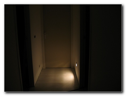

Downlight effect in hallway

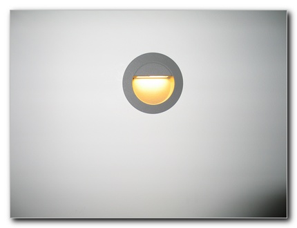

in-wall Downlight detail (12.5cm diameter)

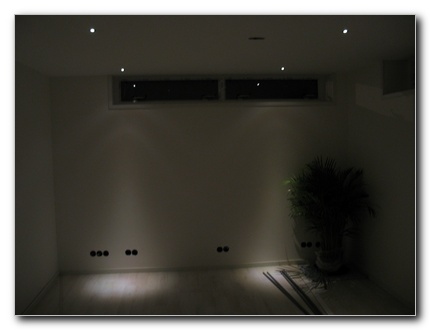

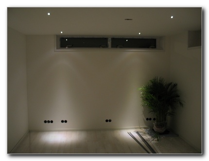

Bedroom 1W spots full power
Bedroom 1W spots half power

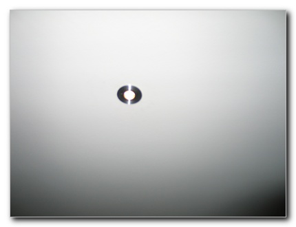

The Led Spot detail

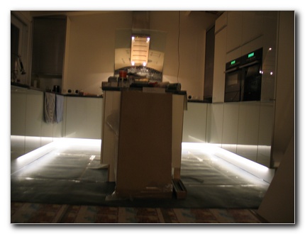

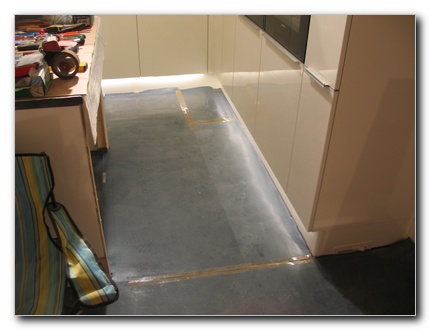

The kitchen part with some better picts:
The kitchen LED strips (no flash)
With flash it even looks good
I needed to put the LED strip on a Aluminum L (10x20mm) shaped strip, so I could remove when needed and also due to the fact that the door fronts do not extend down past the bottom of the cabinet and from a distance you could see the dots of the LEDs. Now the L strip is masking the view.

Indeed those are quite big, about 12cm and 8cm deep.
