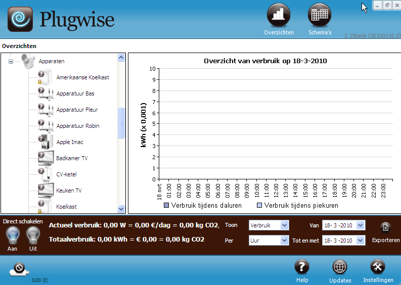

BIG PROBLEM !!!
The source software can't communicate with the stick, so no communication at all.
However, the plugwise server does work without any problem.
I wanted to check if the standby function issue was solved, but I'm unable to test this with a non-working source.
Am I the only one with this problem, or just the first one who installed it ??

@Rien,
I find your experience very strange, not heard before.
Could it be that you choose to update the driver? That could explain this.
Than you just unplug the stick and plug stick back in again.
Please let us now if the issue is solved in your situation.

Re: New beta Plugwise Source 2.15 Beta 20100316 (RelC) available
It is strange. As I said the plugwise server is running without a problem(also with the HS plugwise plugin), but as soon as I start the source there's no communication at all.
I did not install a new driver...
The update wizzard is also stopping (nakijken plugwise netwerk) during the update process
I will try and unplug the stick...
/Rien
No, still the same problem... See screenshot
- 2010-03-18_1117.png (102.19 KiB) Viewed 14148 times
Hmmm....that's really strange.
Maybe you can try running the update by setup http://www.myplugwise.com/source/pwsetup2.15beta.exe
This will also change the version to .1 (minor change).
Maybe you start first the dedicated web server and after that the Source.
That's not possible. So I would suggest. Kill all Plugwise processes (webserver and ....).
Disconnect stick wait a few second and reconnect again.
Start only the Source (so without de dedicated webserver).
I am convinced it's not a problem in this version of the Source.
I uninstalled and installed the beta software al over again, but with the same result.Reinder wrote:Hmmm....that's really strange.
I'm lost now....
Does someone have a 3.14 version for me ??
IK heb 3.14 inmiddels
Ben terug gegaan naar 3.14 en het werkt weer voor 100 %. Weer een upgrade gedaan naar de laatste beta en het probleem is weer terug !!!!
Dus het moet toch echt aan de source software liggen, alhoewel ik de enige ben die er last van heeft. Met 3.14 werkt het gewoon.
Ik zie het stick icontje af en toe wel oplichten (1 a 2 seconden) maar er gebeurd verder niks.....
hmmmm. that's absolute very strange. As far as I know, your are the only one...
