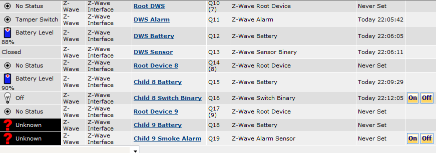

This is what came up in the logs when I imported devices:

The problem is that I can not send a command to activate the Siren, and when clicked on tamper switch Siren begins to sound, but in the logs appears:
Warning - In Set Level for device Z-Wave Z-Wave Interface Root Device 8 which does not match command type Alarm, and its actual device could not be located - cannot continue.
When the smoke detector is triggered, HomeSeer does not respond.
What I did wrong?

Also for the smoke alarm - it looks like you haven't scanned it properly - try doing a rescan just on the device (while pressing the little button on the inside) to see if you get all the devices - it should have a battery, root device and sensor.
-- Sorry I didn't look properly - you do have all the devices - what works for me is press the alarm test button so it updates homeseer (cover your ears though ;) ) but doing a rescan and a few optimises would prolly not hurt either.

After upgrading HomeSeer to 2.4.0.56 in the logs appears supporting COMMAND_CLASS_ASOCIATION_V2, I managed to get to work Smoke Detector, by pressing link key and while it stay awake add homeseer in asociation.Thanks
But with the siren all the same thing, I still cannot activate the siren, turning the switch binary to ON.
Can you write in more detail what Siren do you have and how to make it work?
I am trying to configure it for almost a week.
Thank you!
