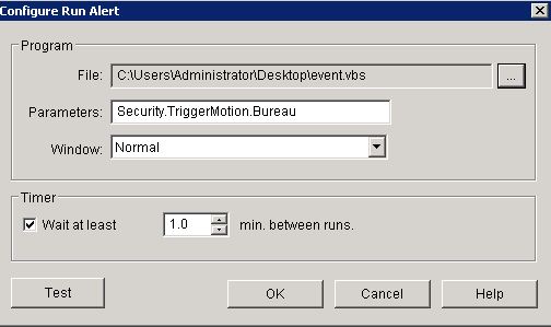

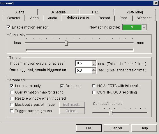

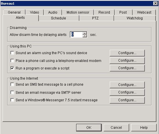

Last step is to configure blue Iris to enable motion detection and enable an alert as shown below:

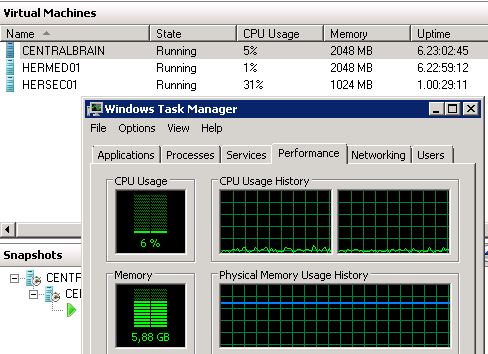

I must say this really works very good, I have 3 virtual machines running with HyperV on an intel 3Ghz Core2 with 8Gb of RAM. The BlueIris software recording 6 camera's uses almost no CPU.
