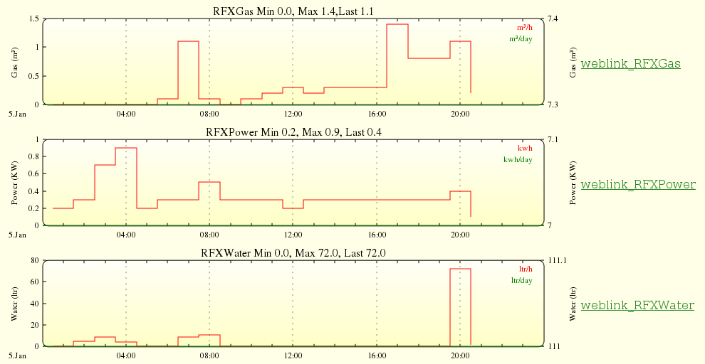

With much help of Willi Herzig, we got in fhem also support for the rfxmeter.
Here some screenshots and configs
RFXMETER:
RFXGas (CNT: 2104.17)
RFXPower (CNT: 7820.434)
RFXWater (CNT: 211419)

Well there is no support form fhemobile yet, but in the next version the oregon sensors will be supported.
For support for the rfxcommeter, I must know how de em1010wz looks like so I can look how to get the rfxcommeter supported.
There is also a way to make fake devices on fhem, and run a script and trigger values
for example, now I make from an oregon an HMS device, to see it in fhemobile
