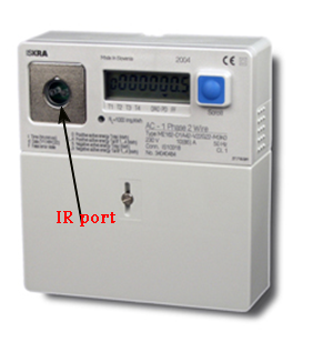

there is also an optical port on your meter
You can use this with ir sensor also to count pulses and probably get the Text of the counters

Re: ISKRA ME162
thats not what i mean, a flashing led is different
the IR port is the big opening with a diode in the middle
you cant see it flashing

I also have a ISKRA (different type) with such a IR port.
Wonder how you can interact with it without having a engineering password or pin or whatever needed to access the data.
If I can get readonly access to retreive the data found on te LCD screen I would be very happy.
Any idea how to do this?
