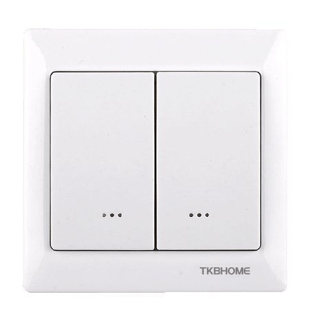

Another company that is going to deliver zwave product.
The first switch is available.
Dual switch including frame and the paddle.
I'm sure that some people will be happy with the build in indicator leds
first con: Logo
Price 55 euro
Specs:
Power rating: 230V, 50 Hz
Wiring: 3-wire system
Maximum loads: all loads up to 6 A
Wireless behaviour: receiver and transmitter if further units are associated
Z-Wave type: slave
Distance: up to 30 m in buildings
Display: 2 blue LEDs show switching status
Interaction: two buttons for switching, inclusion, exclusion and association
Installation: in a pattress box
Power supply: via 230 V power

This switch looks for me as simple clone of the ZRM230 from ACT...

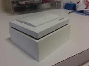

Hi everyone, I am an engineer from eVida Smart Home Care, a Z-Wave system distributor & integrator in Singapore.
We have tested the TKB_TZ66-D switch long time ago. One of the problem is that it cannot fit nicely into an external pattress box due to its size (a normal pattress box is too shallow to contain it). You may refer to the attached photo to understand what I mean. For houses with recessed hole for internal pattress box, you need at least a 70mm deep hole for a safe buffer to house the TKB_TZ66-D, and this could lead to extra charges in renovation.
In addition, a neutral wire is required from the ceiling lamp to the switch level. This again is a disadvantage for those with concealed wirings in existing home, unless you won't mind laying an external trunking for routing the neutral wire. Otherwise, it is best to install the TKB_TZ66-D during your house renovation - hence you really have to plan ahead.
