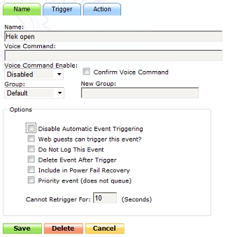

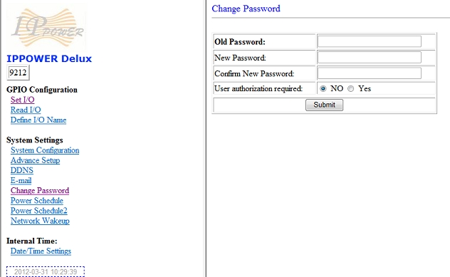

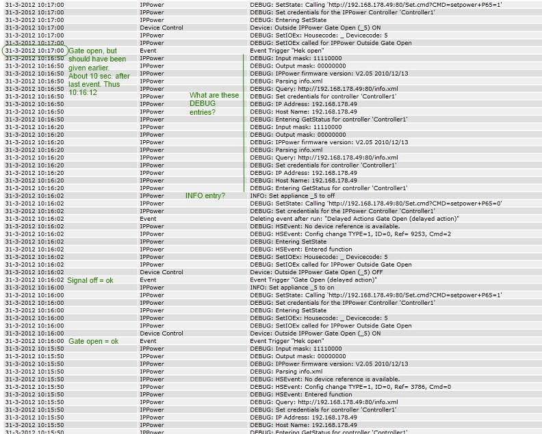

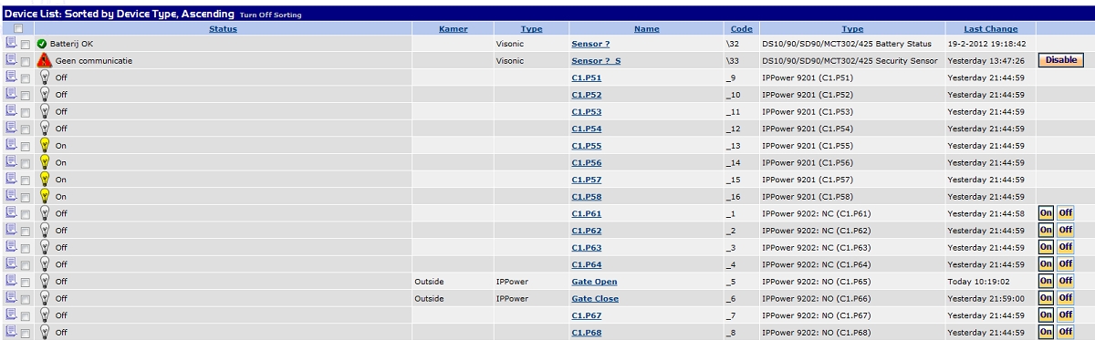

1. What are all these DEBUG entries in my HS log? Did I configure something wrong? (please find enclosed various screenshots)
2. In order to keep my gate open, I need to re-run the HS Event Gate Open every 10 seconds. But this doesn't seem to happen. It runs again after 1 minute, but I have no idea where to look what the problem could be.

DEBUG entries in my Homeseer log are by choice. Within the IPPower Plugin settings, you can apparently set the level of info detail you want recorded in the HS log.
DEBUG is thus not an error message, but the most detailed level of log entries.

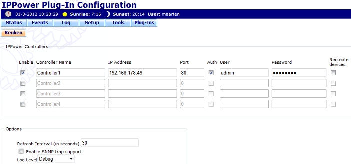

Re: IPPower HS log entries, I don't understand them?
The reason the state change is only noticed every 60 seconds is your configured refresh interval of the plugin. This interval can be configured in the plugin configuration page.

Rene,
Thanks for the reply. But to my, my setting looks like it refreshes every 30 seconds? (see 4th attachment)
