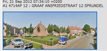

- Afbeelding tonen van de locatie waar de melding is (indien aanwezig)
- Link toevoeg zodat wanneer je op de afbeelding klikt direct naar google maps gaat om te zien waar dit precies is.

   For Each item In itemList
     Titel(Teller) = ""
     Titel(Teller) = item.SelectSingleNode("title").text
     TimeStamp(Teller) = item.SelectSingleNode("pubDate").text
     If DebugDetails = true then hs.WriteLog("<b>AZ_" & strLogID & "_Info</b>", "Titel:" & item.SelectSingleNode("title").text )
     If DebugDetails = true then hs.WriteLog("<b>AZ_" & strLogID & "_Info</b>", "pubDate:" & item.SelectSingleNode("pubDate").text )
     lon(Teller) = 1000
     lat(Teller) = 1000
     Try
       lon(Teller) = CDbl(Replace(item.SelectSingleNode("geo_long").text, ".", "," ) )
       If DebugDetails = true then hs.WriteLog("<b>AZ_" & strLogID & "_Info</b>", "Longitude:" & lon(Teller) )
     Catch ex As Exception
       lon(Teller) = 1000 'Out of range
       If DebugDetails = true then hs.WriteLog("<b>AZ_" & strLogID & "_Info</b>", "Longitude: NO LONGITUDE")
     End Try
     Try
       lat(teller) = CDbl(Replace(item.SelectSingleNode("geo_lat").text, ".", "," ) )
       If DebugDetails = true then hs.WriteLog("<b>AZ_" & strLogID & "_Info</b>", "Latitude:" & lat(Teller) )
       lat(Teller) = 1000 'Out of range
       If DebugDetails = true then hs.WriteLog("<b>AZ_" & strLogID & "_Info</b>", "Latitude: NO LATITUDE")
     End Try
     If DebugDetails = true then hs.WriteLog("<b>AZ_" & strLogID & "_Info</b>", "Afstand:" & afstand( Longitude, Latitude, lon(Teller), lat(Teller) ))
     Teller = Teller + 1
  Next
   ' We have all the data we need
   ' lets do something with it
   'Apply filter
   'Delete content if filter doesn't apply
   If strFilter <> "" Then
     For Count = 0 To Teller
       If Instr(UCase(Titel(Count)), strFilter) = 0 Then Titel(Count) = ""
     Next
   End If
   'Apply distance only on those
   'where Titel is not empty
     If Len(Titel(Count)) > 0 Then
       'Check if the item has coordinates
       If lon(Count) < 1000 And lat(Count) < 1000 Then
         If afstand( Longitude, Latitude, lon(Count), lat(Count) ) > lngRadius Then Titel(Count) = ""
         If DebugDetails = true then hs.WriteLog("<b>AZ_" & strLogID & "_Info</b>", "Afstand:" & afstand( Longitude, Latitude, lon(Count), lat(Count) ))
       Else
         Titel(Count) = ""
       End If
     End If
   Next
   'Transform text, add an image and
   'apply time and date stamp
       'Add date and time stamp
        Titel(Count) = TimeStamp(Count) & "</br>" & Titel(Count)
        'Replace P2000 codes for something more readable.
        Titel(Count) = ReplaceCodes( Titel(Count) )
        'Add an image
        If lon(Count) <> 1000 And lat(Count) <> 1000 Then
          If blnAddImage = true Then Titel(Count) = AddImage(Titel(Count), blnImageLink, lon(Count), lat(Count) )
        End If
     End If
   Next
   If Debug = true then hs.WriteLog("<b>AZ_" & strLogID & "_Info</b>", "***************************")
   If Debug = true then hs.WriteLog("<b>AZ_" & strLogID & "_Info</b>", "* Gevonden items die voldoen. *")
         hs.WriteLog("<b>AZ_" & strLogID & "_Info</b>", "Titel : " & Titel(Count) )
       End If
     Next
   End If
   ' We have filtered all the data
   ' No its time to display things
   Dim Test As Boolean = false
   Dim Teller2 As Integer = 0
   For Count = Teller To 0 Step -1
        'Is this call already in a device
        Test = false
        For Teller2 = 0 To intNumberOfMessages - 1
          If hs.devicestring(strHouseCode & Val(strDeviceCode + Teller2)) = Titel(Count) Then Test = true
        Next
        If Test = false Then
          'Move all calls to the next device and
          'then load this call into the first device
          If intNumberOfMessages > 1 Then MoveMessages(strHouseCode, strDeviceCode, intNumberOfMessages)
         hs.SetDeviceValue(strHouseCode & Val(strDeviceCode), 0)
         hs.WaitSecs(1)
          hs.SetdeviceString(strHouseCode & Val(strDeviceCode), Titel(Count), true)
          hs.SetDeviceValue(strHouseCode & Val(strDeviceCode), 1)
          hs.setdevicelastchange(strHouseCode & Val(strDeviceCode), now)
        End If
     End If
   Next
End Sub
' Additional functions and such
' Replace the P2000 codes with
' something more readable
Function ReplaceCodes(ByVal Titel as String) As String
  Titel = UCase(Titel)
  Titel = Replace(Titel, "</BR>A1 ", "</br>Ambulance met optische en akoestische signalen. ")
  Titel = Replace(Titel, "</BR>A2 ", "</br>Ambulance zonder optische en akoestische signalen. ")
  Titel = Replace(Titel, "</BR>B ", "</br>Besteld vervoer. ")
  Titel = Replace(Titel, " A1 ", " Ambulance met optische en akoestische signalen. ")
  Titel = Replace(Titel, " A2 ", " Ambulance zonder optische en akoestische signalen. ")
  Titel = Replace(Titel, "</BR>PRIO: 1 ", "</br>Brandweer met optische en akoestische signalen. ")
  Titel = Replace(Titel, "</BR>PRIO: 2 ", "</br>Brandweer met mogelijk optische en akoestische signalen. ")
  Titel = Replace(Titel, "</BR>PRIO: 3 ", "</br>Brandweer. ")
  Titel = Replace(Titel, "</BR>PRIO 1 ", "</br>Brandweer met optische en akoestische signalen. ")
  Titel = Replace(Titel, "</BR>PRIO 2 ", "</br>Brandweer met mogelijk optische en akoestische signalen. ")
  Titel = Replace(Titel, "</BR>PRIO 3 ", "</br>Brandweer. ")
  Titel = Replace(Titel, "</BR>BR ", "</br>Brandweer. ")
  Titel = Replace(Titel, "</BR>P ", "</br>Personenauto. ")
  Return Titel
End Function
'Do some markup to the status of the device
'Add an images and a link if requested
Function AddImage(ByVal strStatus As String, ByVal blnImageLink As Boolean, ByVal Longitude As Double, Byval Latitude As Double ) As String
  strStatus = strStatus & "</br>"
  If blnImageLink = true then
    strStatus = strStatus & "<a href='http://maps.google.com/maps?q="
    strStatus = strStatus & Replace(CStr(latitude), "," , ".") & "," & Replace(CStr(Longitude), ",", ".")
    strStatus = strStatus & "'></br>"
  End If
  strStatus = strStatus & "<img src='"
  strStatus = strStatus & "http://cbk3.google.com/cbk?output=thumbnail&cb_client=maps_sv&thumb=2&ll="
  strStatus = strStatus & Replace(CStr(latitude), "," , ".") & "," & Replace(CStr(Longitude), ",", ".") & "&w=300&h=118"
  strStatus = strStatus & " ' >"
    strStatus = strStatus & "</a>"
  End If
  Return strStatus
End Function
'Move the messages from the first device
'into the next device and cascade this
'to the last device
Sub MoveMessages(ByVal HC As String, ByVal DC As String, Byval Devices As Integer)
   Dim i As Integer = 0
   For i = Devices To 1 Step -1
     hs.Setdevicestring(HC & Val(DC + i), hs.devicestring(HC & Val(DC + i - 1)), true)
     hs.SetdeviceValue(HC & Val(DC + i - 1), 0)
     hs.SetdeviceLastChange(HC & Val(DC + i), now)
     hs.SetdeviceStatus(HC & Val(DC + i), hs.deviceStatus(HC & Val(DC + i - 1)) )
   Next
End Sub
' Calculate the distance
Function Afstand(Byval lon1 As Double, Byval lat1 As Double, Byval lon2 As Double, Byval lat2 As Double) As Long
  Dim theta As Double
  Dim dist As Double
  theta = lon1 - lon2
  dist = sin(deg2rad(lat1)) * sin(deg2rad(lat2)) + cos(deg2rad(lat1)) * cos(deg2rad(lat2)) * cos(deg2rad(theta))
  dist = acos(dist)
  dist = rad2deg(dist)
  dist = dist * 60 * 1.1515
  ' Convert from miles to meters
  dist = (dist * 1.609344) * 1000
  Return CLng(dist)
End Function
'  This function get the arccos function from arctan function
Function acos(rad)
  Dim Pi As Double = 3.14159265358979323846
  If Abs(rad) <> 1 Then
    acos = pi/2 - Atan(rad / Sqrt(1 - rad * rad))
  ElseIf rad = -1 Then
    acos = pi
  End If
End function
'  This function converts decimal degrees to radians
Function deg2rad(Deg)
  deg2rad = CDbl(Deg * pi / 180)
End Function
'  This function converts radians to decimal degrees
Function rad2deg(Rad)
  rad2deg = CDbl(Rad * 180 / pi)
End Function
