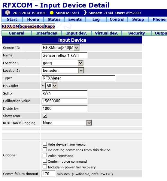

Last month I bought also a rfxmeter with rfxpulse and installed it in Homeseer2.
I see the kWh-meter in HS but no change after a few houres of the number.
Here the information of my installing and the line in HS2 of the kWh meter.
What did I wrong? Or did I forgot something?
B.R. Wim
B.R. Wim

- Advanced Member
- Posts: 718
Re: rfxmeter/pulse installation
Nobody ?
Is de LED on the RFXPulse blinking?
Did you adjust the sensor?
Do you receive an updated counter in RFreceiver?
- Advanced Member
- Posts: 718
I connected 1 sensor to the rfxmeter and 1 red led is burning continue. No blinking.
I stick the sensor on the glass of the kWh-meter. But what do you mean by adjust the sensor?
How do I receive an updated counter in RFreceiver.
B.R. Wim
B.R. Wim
- b_weijenberg
- Forum Moderator
- Posts: 1746
- Location: Netherlands
See chapter 2.5 in the RFXPulse module.pdf
