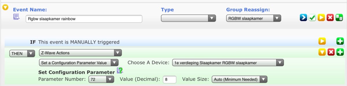

Did anyone ever managed to use the "fireplace, storm, rainbow, police lights" ?

Re: Fibaro rgb module with homeseer?
Yes i managed to implement this in HS3, by a script, and since the newest zwave plugin via events (set configuration parameter).
parameter 72 to value X (programma)
I use this for alarm tripping (police program)
Bart
Bart
Would you mind sharing the script ? so i can see what values is can use and to set the valuesbartbakels wrote:Hi,
Bart
You dont need the script , its a zwave action in the events now.
Aha, but where can i find the values i did not find them in the manual of the RGBW modulebartbakels wrote:You dont need the script , its a zwave action in the events now.
Bart
Values 1-10.
6= fire-like light
7= kind of lightning, random white flashes and then slowly dimming blue light
8= rainbow with bright colors
9= rainbow with softer colors
10= rapid flashing red/blue/white
I only have an rgb strip attached to it, play with the values.
6= fire-like light
