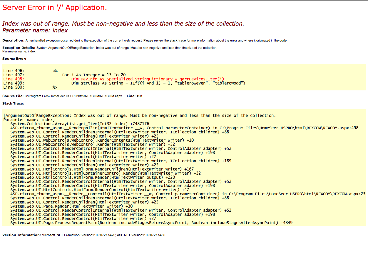

I get attached problem when trying to use the interface tab. Tried to re-install te plugin, deleted devices with the same Housecode, but no progress. Anybody know how to fix this?

I don't know what you try to do here but the error says that the number that is tried in line 498 Item(i) is not available.
There are several ways to fix this. First make sure that garrDevices.Item(13) to (20) have values. Make sure that the array garrDevices have atleast 20 elements. Or put an Try .. Catch.. block around this

Funny thing is. I dont try anything but opening the interface ;)
