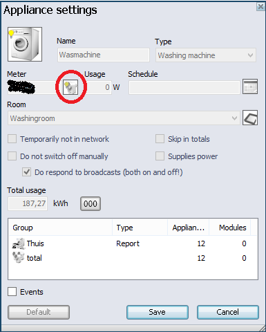

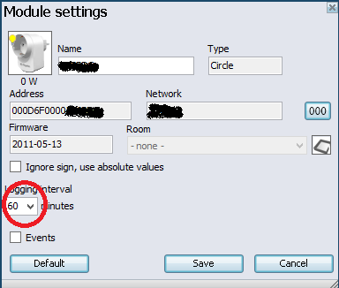

Have you checked the logging interval of these appliances?
You can see it in the Module settings.
To go there, right click on a plug, then Properties, then click on the small icon next to "Meter".
There you see the interval. See image.
What does it say?

Darwusch wrote:Have you checked the logging interval of these appliances?
What does it say?

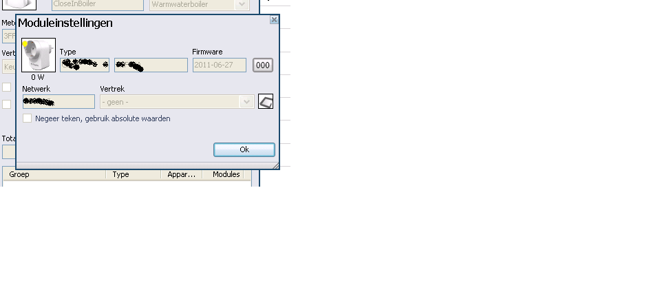

Edwin
Posts: 447
Re: experts gezocht
Post by Edwin »
Darwusch wrote:Sure?
Do you not have this button?
I use 2.24 beta but had this button in 2.23 too I think.
yes i have that button but when i push it i dont get logging interval to see
plug instel.png (9.44 KiB) Viewed 17931 times
