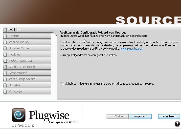

i have now fitted a smile to the smartmeter,.. but how do i get the counters in source?
i can't find that in the manual,....
is there something special i have to do to get the power and gas counters in source :( :?:

you have to run the config of source where you add your plugs and check a checkbox there which says you have a smile.

I have lokkt for the checkbox , can't find it....
is this the place where the checkbox has to be?

Re: Plugwise Smile P1
Post by Akatar »
nope, on you're first screen

oke thanks got it,.. :D .did not now there was a configuration wizzard :(
got the 2 divices, gas and power.
it seems the powercounter do's not split the 4 seperate counters (low,hight and production Low,and high).
